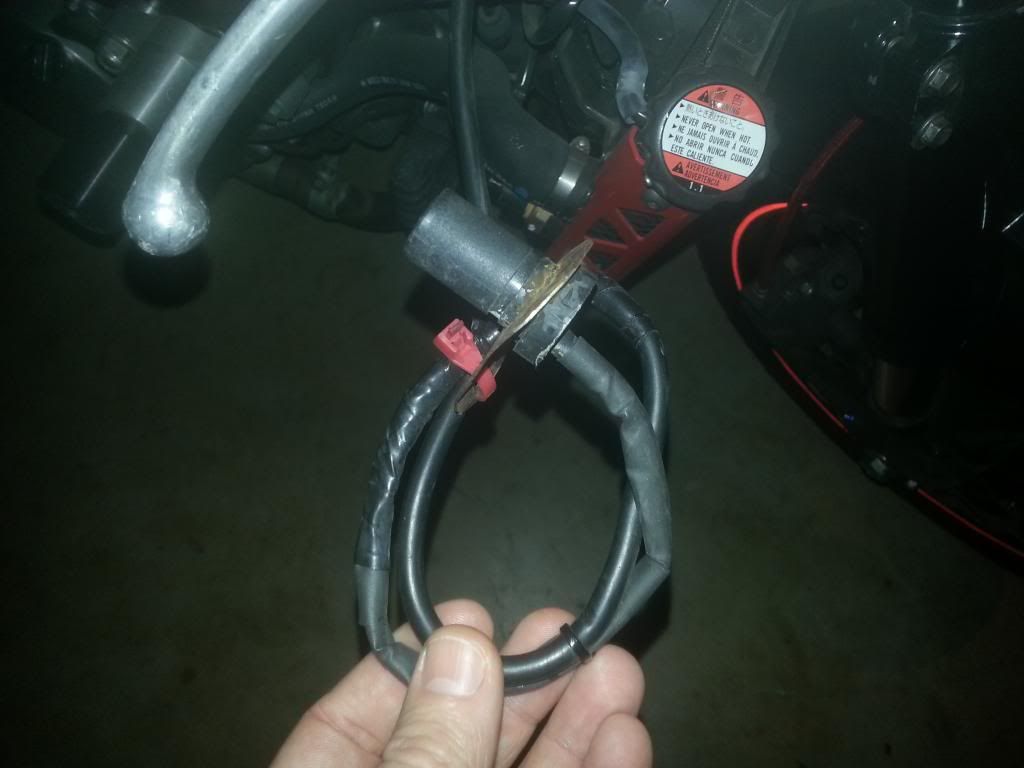

Hey Guys I have gone through this thread multiple time and a few others and cant seem to figure why my speedo is reading out double the speed. GPS says 30mph and my speedo say 60mph.
The bike is a 06 SV650 with a 04 GSXR front end swap. The wiring is just as its been stated here with the Cherrie sensor and 8 magnets.
Any help would be much appreciated.
The logical thing to do would be to remove four of the magnets and try again.
I had a similar problem. I have an '03 SV650 with an '02 GSXR front end. I bought it with the speedo/odo reading double with the stock rotors w/ 4 magnets.
I changed out the rotors to a 6 button design. I taped a single magnet between a spoke and it registered what appeared to be a 1/4 of the speed when moving. I taped another magnet on an opposing spoke and it registers correctly now. I'm assuming 4 magnets would double the speed again but realistically it's working well now.
Anybody know of why this may be?
So I have tried a lot of different set ups and still not reading the right speed. I even went down to one magnet and it still reads high.
What about if you take all the magnets off?
The cherry sensor has a magnet built into it and was originally designed to trigger off of metal of gear teeth, not magnets in rotors. I am guessing it is probably triggering off of the metal of the carrier (if it is steel) or the webs of the braking surface that meet the rotor.
I don't use any magnets at all.
This is the sensor I got.
http://www.jameco.com/webapp/wcs/st...1&langId=-1&productId=512401&storeId=10001&ddkey=http:StoreCatalogDrillDownView
Anyone have any other ideas what the issue might be?
You're too close to the rotor. When I first did my swap, the speedo would show 8+mph just walking the bike. I bent my sensor mounting bracket back a bit from the rotor and it reads fine now.
