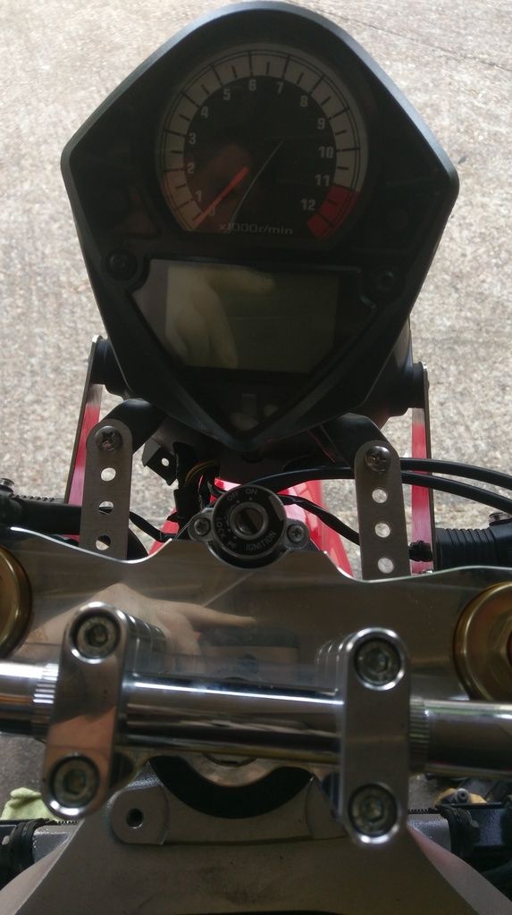

Triple Clamps:
You can mix & match a bit here:
The ideal top clamp I believe would be the 04/05 600/750 clamp
This has ignition offset to the right (same as SV and more conducive to the Vee shape of the front of the speedo for naked)
It has a 30mm offset and a 25mm bore.
Direct fit on 04/05 l600/750 lower triple clamp/forks
To fit on 06+ 600/750 forks/lower triple, bore stem hole to 28mm
To fit on 05/06 1000 bottom triple, bore stem to 28mm
If you have no access to machining, then the 05-06 1000 top clamp will fit directly on the 06+ 600/750 steering stem. This clamp has ignition 'straight ahead. The steering lock WILL lock, albeit with the wheel straight ahead, as opposed to the conventional full left position.
06+ 600/750 top clamps obviously 'fit' their own forks/bottom triple, however, the ignition is offset to the left; it requires some machining of the ignition module to avoid interference with the frame on the left side and the steering lock will not function without drilling frame. This makes it a less ideal choice.

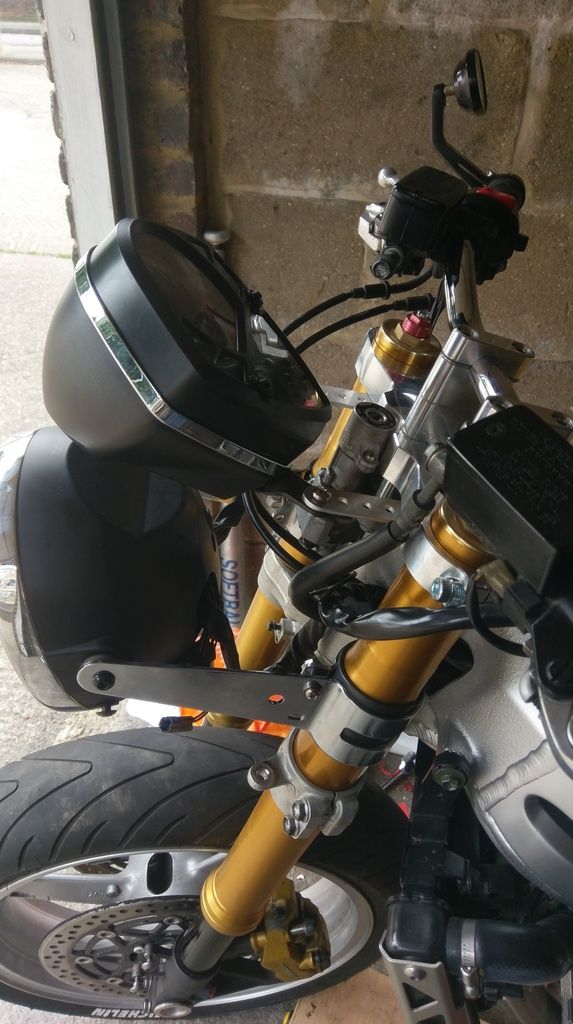

Hey guys, Just bought my SV last weekend and the first thing I looked up was to do GSXR USD fork swaps.
Now I don't do any machining, and would like to keep this project cheap. I'm not sure how much machining anything costs, but I can imagine it's expensive.
From reading the first page on this thread, I gathered that the first thing I need is 05-06 1000 top clamp to go on 06+ 600/750 steering stem. I'm still trying to make sense of all the other information, but it's late and I'm too tired.
Can anyone help me start this off with what else I'll need to get/do etc...?
Thanks heaps!
#955 ·
That will bolt right up (although I'd recommend changing your steering head bearings) and give you steering lock with the bars centered.
#957 ·
Any front end swap will require some fiddling to get the speedo working again.
Any 00s front end will bolt right up, and the steering stops will work. Early forks are on the short side, your best bet for length is 06-09 600/750 (600 are likely sprung closer to right).
There won't be a steering stop with them, though.
topyokes.com made a custom top triple clamp for me, which fits my 06 600 forks/triple clamp and gives me proper steering lock and mounts for upright handlebars.

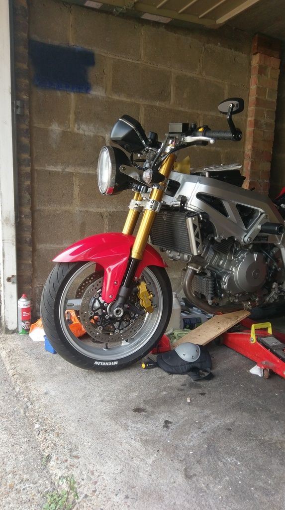

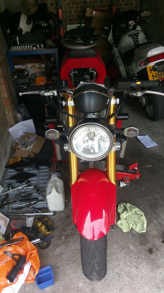

Righty, my bike's together, everything is torqued up correctly - I'm finding it's weaving side to side at slow speeds. I've done the following:
1. Ensured correct pressure is in the tyres
2. Loosened off the lower triple clamp pinch bolts and bounced the bike up and down with the brakes applied
3. The bearings are new, brand new...both top and lower. The triples are torqued to factory spec
4. Front tyre wear is even, no squaring off
Here's my thoughts:
fork(s) are bent. They do look poker straight to look at and the seals are fine, no leakage whatsoever.
Discs are bunk, can't tell if they're straight tbh. Watch this video I filmed, can someone else check if they have the said steering wheel style side to side freeplay:
The R6 Calipers aren't aligned properly. As there's no locating dowels - I'm assuming the bolts themselves act as a centering method? If not, is there a trick to this as the standard GSXR calipers also don't have locating dowels.
Maybe the bearings aren't seated properly? I placed them, torqued the top nuts down as per the manual with the correct tool, also ran side to side about 10 times to seat them properly them backed off the top nut a quarter turn as per the guide. Looking at the bottom triple, it sits VERY slightly off completely flush of the headstock, which makes sense or it'd rub.
Any thoughts?
