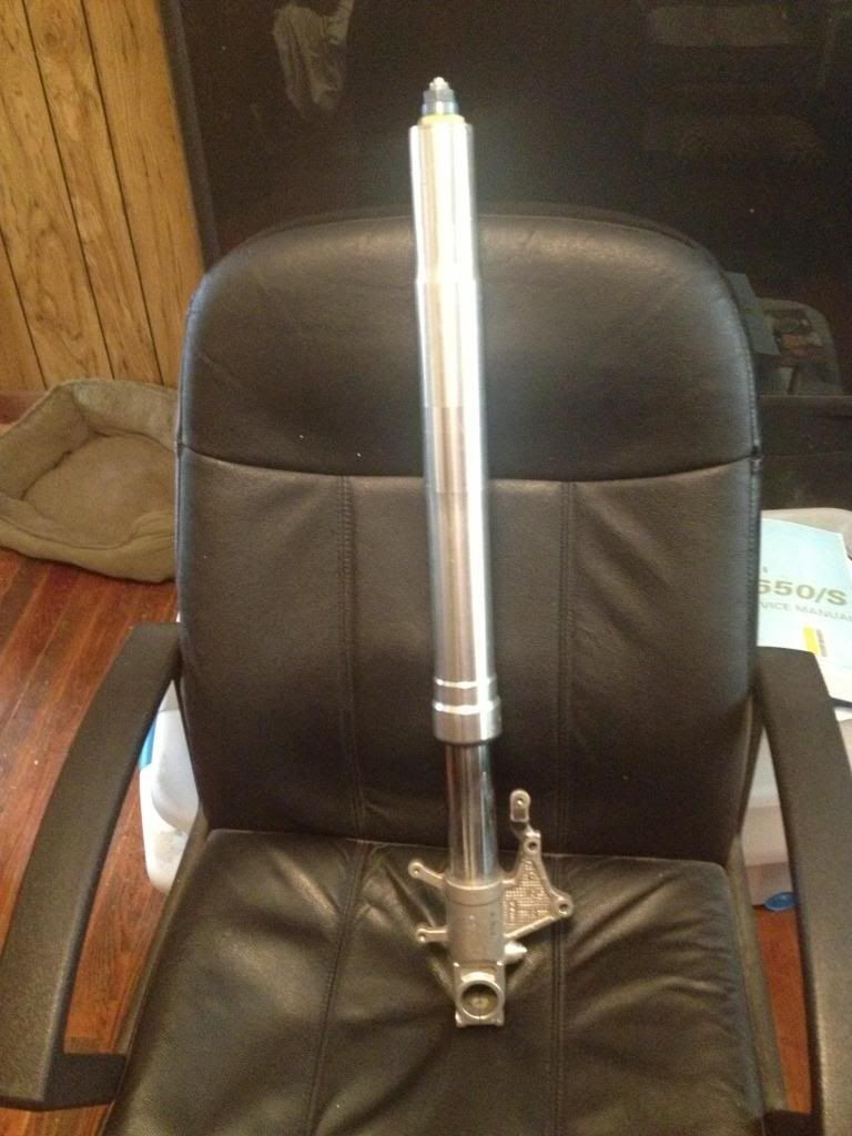

wow I had forgotten how much of a PITA it was to put pics on svrider......I think the last time I used photobucket was also for here
My forks and the part #, I was told they are from an 03 GSXR 600, but have been told in here that o3 600s didn't have USD Showa forks, so can anyone narrow down what these came from as I assume I need it specificly for an axle and to get the diameters for triples?
