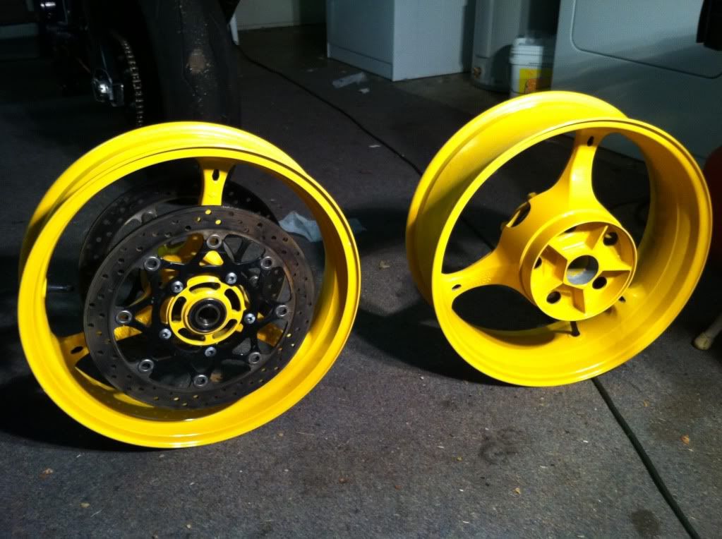

Hey all, my friend has a front wheel in his garage left by the previous owners of the house. He's pretty sure it's an earlier GSXR rim because of the 320mm rotors. Looking at the matrix it could be SRAD/TL/00-03 750', etc.
How can I tell which model it's off of? I checked but there is no part number I can see on the outer rim.
Is there something I can check or measure to generally see what type of rim this is?
#446 ·
Here's a pic and there are numbers where the spoke meets the outer rim.
Wadda you think?
The no. I was talking about are somewhere on the middle on the spoke, between outer rim and hub behind the outer rotor.
The 1. gen busa,TL models and 600/750 srad models share the same rim so they might have the same part no. and that what it looks like what you got
Why do you need to know from which model it is?
#448 ·
I am pretty sure that Suzuki changed the wheel design on the 01+ 600 and the 00+ 750 models.
While they used the same 320mm rotors till they switched to radial,
they changed the spoke design from round like the SV and the wheel you got to spokes with edges.
