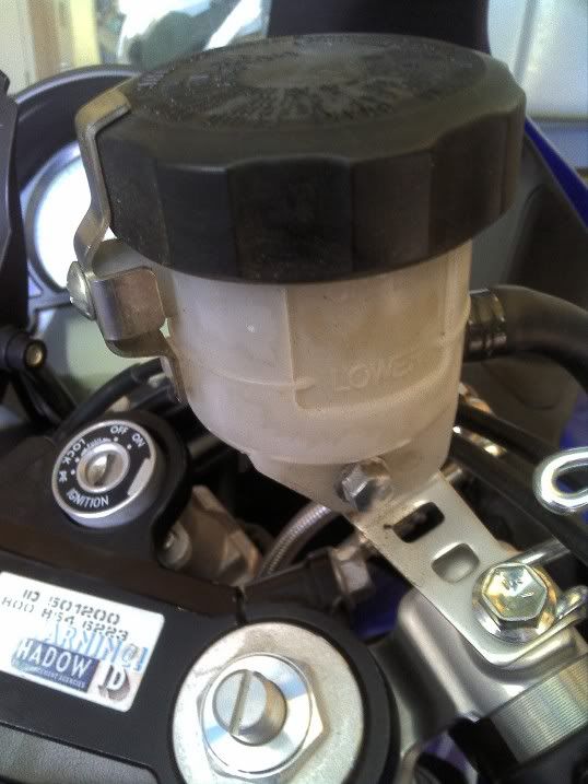

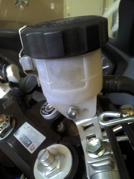

Has anyone seen a reservoir like this?
It looks like it is coming apart in between the plastic.
Also looks like it could be leaking.

It used to look more solid all around it. Now the plastic looks clouded. Look at the second picture in between Upper and Lower.
2,558 Posts
That looks like the rubber booty (that sits underneath the cap) making contact with the resevoir sides. Sometimes the booty gets stuck in weird shapes, pop the cap off and makes sure it's shaped like a cup.
