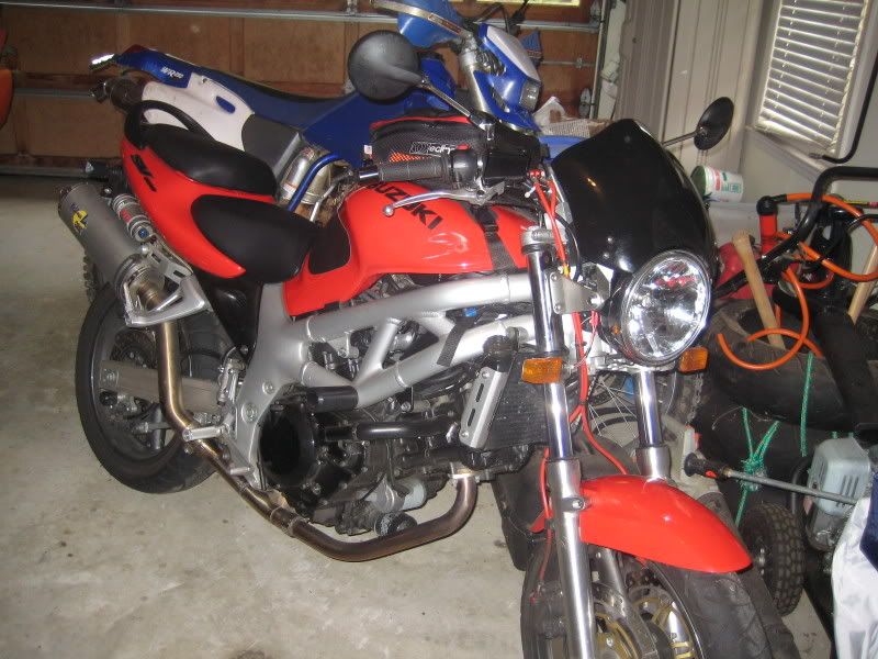

I've read and posted some of the other threads about dual sporting an SV and have some additional Q's.
I bought an older gen 1 SV naked model. I don't have a lot of money in it. I come from a dirt background and still ride dirt and dual sport on my KTM EXC450. Been thinking about getting a big dual sport where I can do both longer distance rides with forest roads thrown in. Some the riders around here have bikes like: KTM 990 Adventures, BMW GS 1200cc?, Triumph Tigers, and V-Stroms.
With cheaper mods, can I make my SV into a bike that will keep up with those beastly dual sports? They are mostly doing smooth dirt and gravel roads on them anyway - not real knarly stuff. The SV seems to have some advantages over them on dirt roads, and some disadvantages. Advantages - Lower seat height and a good deal lighter. Good torque. Disadvantages - Suspension travel and short wheel base.
About my bike - current mods that might help off road:
Racetech front suspension, Fox Shock rear. (Same travel, better suspension) High mount Leo Vince exhaust. Jet kit and tuning. Bar risers 1.5 - 2 inches. Braded brake lines.
Other mods considering - More dirt type handlebars, raising the front fender slightly like a scrambler, street/dirt type tires. Bash plate
Here is my bike:

Nothing cheap is going to add the suspension travel they have on you. Other than that...it still can be ridden on dirt roads if you understand it's limitations. Look at the triumph scrambler. Throw on some Michelin Anakees, throw on a radiator guard, and maybe make a bash plate for the exhaust.
RandyO swears his SV was far better off road then his vstrom. The biggest advantage the bikes you listed have in the riding you describe is long-distance comfort and carry ginormous amounts of luggage. I suppose the only reasonable SV "mod" would be appropriate dual sport tires. I do also recall that there is a way to increase travel a bit by removing a bottom-out cone but honestly don't remember the context at all. Something for you ot try searching for.
anakees don't come in SV sizes
best off road tire I've found are Pirelli MTR60-Corsas, Distanzias come in SV sizes, and work better on the street than the MTR60s but not as well off road
suspension travel isn't as important as ground clearance, but I never had a problem carefully picking a line that avoided clearance issues
my opinion the SV is better off road than the strom cause of the weight difference, the V-strom is big & heavy, and the weight is also higher

RandyO and others - Did you guys run the stock front fender position or did you raise it a little? Will gravel tear it up? Thinking about trying some forest service roads tomorrow with the way it's currently set up.
RandyO - I appreciate your opinion on this: "my opinion the SV is better off road than the strom cause of the weight difference, the V-strom is big & heavy, and the weight is also higher" Anybody else feel the same way?

Have you made your SV into a Scrambler yet? or do you have another kind of scrambler? I started getting fired up about all this when I saw some post like RandyO's riding through the river. I've been thinking of selling the SV and getting a big dual sport bike. Then I thought, it would be pretty cool/unique to show up in the Forest and Mountain towns with a Dual Sport or Scrambler SV. There would be kind of a uniqueness factor. And I kind of lucked out that the bike I bought had a high mount pipe, significant bar risers and suspension work. At least I'm assuming these things make it more off road worthy.
I don't want to try and fit a square peg into a round hole, but it does seem that with a little money, and a lot less than other local riders have spent on their beasts, I could have a comparable bike. Plus I love the SV motor and the light weight.
I did loosen the front fender bolts and tweak the fender up as much as I could then retightened, I might have gained ¼" in fender clearance, never had any problems with it, occaionally you will hear gravel scraping the inside of the fender

Report on the Idea:
This weekend, had a chance to ride dualsport on my EXC450 (KTM) all day Saturday, then spent all day Sunday riding street (a lot of mountain twisties) and also did a few miles of forest roads, on the SV.
It was a great weekend and was reminded once again what a fun bike the SV is to ride in the mountains. But, to me (and I realize this is a personal taste thing) it really wasn't very fun to ride in the dirt, especially with the comparison of riding a true dualsport the day before. I've ridden my buddies 950 Adventure on the street and have watched another one ride a 950 on forest roads, railing the thing. I just can't see the SV making a decent dual sport bike with just a few mods. The suspension, tire size and wheel base would make it impractical. At speed, there is a tendency to hit rocks embedded in the forest service road and deflect. This combined with lack of suspension and short wheel base could cause the tank slapper from hell.
Now - I would be perfectly comfortable on the bike going down Forest roads, when I had to, to link street routes or to get to a destination. But I would be going slow and not really riding, like I've seen guys do on big dualsports. I think the experience this weekend, showed me to keep the bike focused on what it was intended to do, and not something it wasn't.
Thanks for all the input.

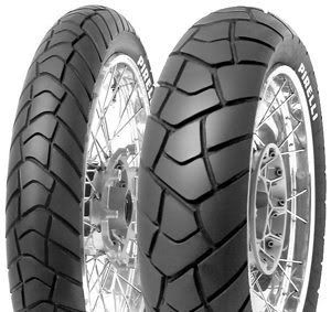

I ran these tires,when i lived up a 1/4 mile gravel road,they worked better than conti's in the loose stuff. :)
Ask about my pock marked radeator. A fender extender would be a good idea.

I ran one set of distanzias , great on the pavement, just ok off pavement, didn't last me any longer than the Pirelli MTR60's
the MTR60s were best I could find for off pavement in SV sizes , but on pavment, in summer temps, they get greasey & overheat and wear out fast, went thru a set in one week once, less than 1000 miles, in winter, on cold pavement, I got 3500 miles or so
