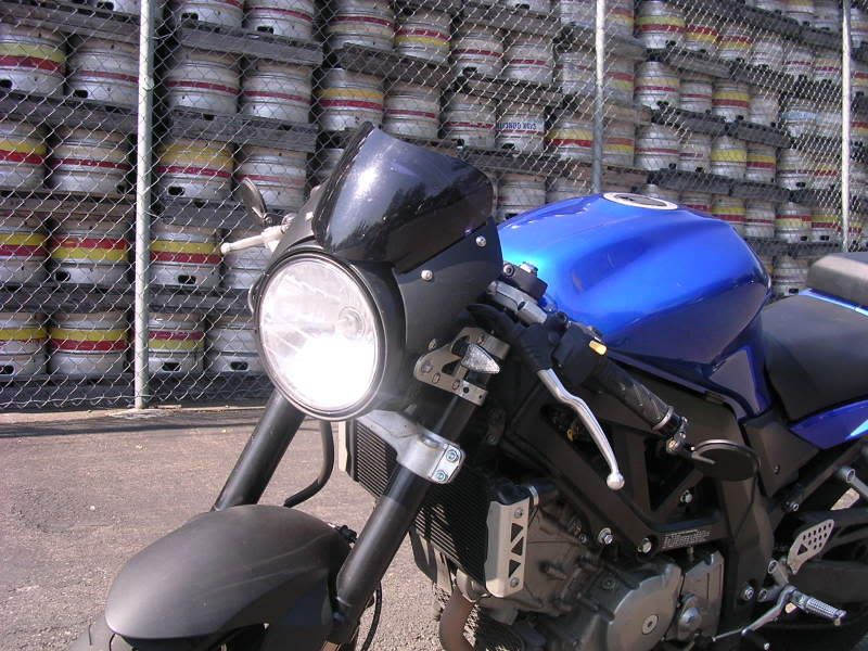

It's a 1st gen, and the pic's a little blurry ... but you get the idea:
(SNIP) Make sure to flat clear it too, I had the hardest time finding matte clear until I looked at Michaels (arts and crafts store).(SNIP)

I've only done the mini fairing and front fender thus far and I'm still contemplating doing the rest. Good luck
