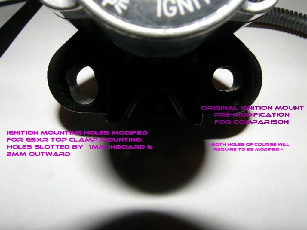

Replied with pics and details of ignition mod
The ignition mounts require a very slight mod to slot the holes in the brackets.
They need to be a little closer together (needs about 1mm inboard on either side) and additionally also extended to position the ignition further away from the head.
The ignition will be very close to the steering head so you need to be sure you give that additional clearance by moving a little further out. after you assemble the top clamp with the ignition on the forks/steering stem, make sure you have some clearance between the ignition & the frame steering head. You don't want that jamming on you!
This is my TL ignition, but the slots are virtually identical: you can see the one on the left has been slotted 'down' & 'in' from the photo perspective. The right one is shown unmodified for comparison but obviously is done similarly.
A rat-tail file is best tool for the job here - just take a few seconds.
