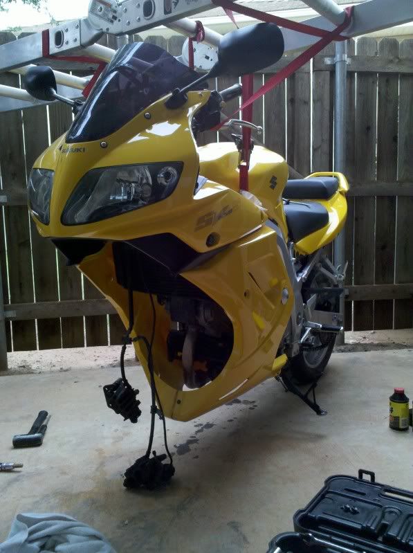

first time I've seen a sv hung from a ladder!! nice looking bike.
I moved here knowing I was moving again in 6 months so I rented a cheap townhouse. Without a garage, I had to get creative on the patio!
