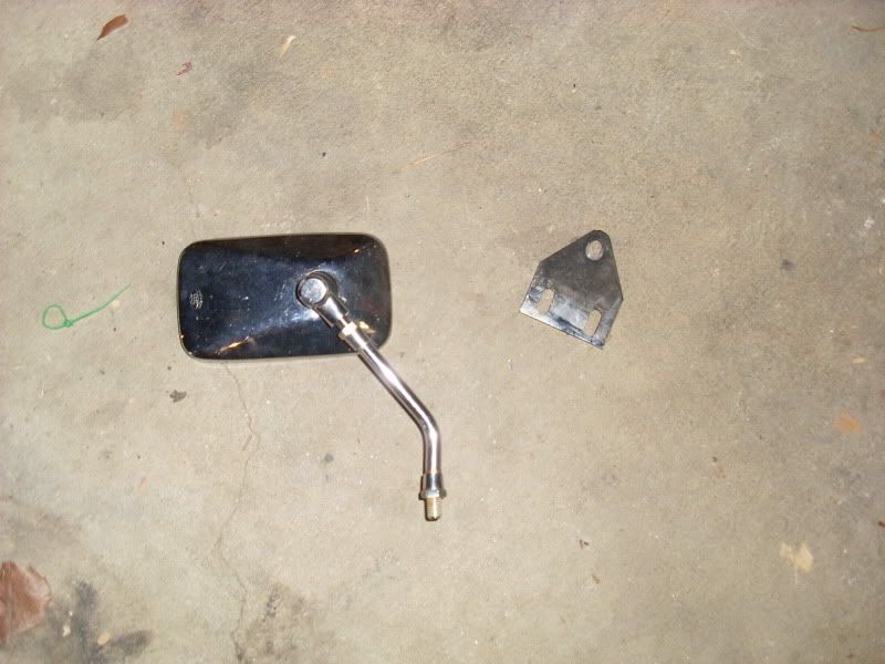

I was thinking about buying a camera mount but then came up with an idea to make my own. Here is how I did it: (youtube link at bottom of post)
Step one: get an old mirror, remove the mirror and keep the stem. Also get a piece of steel and drill a few holes in it

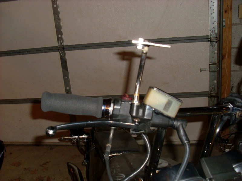

Step two: Put stem on bike and mark where you want the steel piece to be

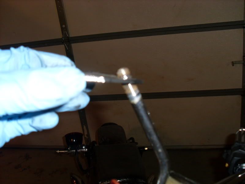

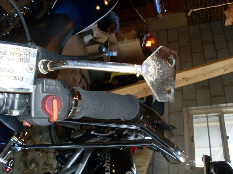

Step 3: Remove stem from bike and weld the steel piece to it, go to your local hardware store and get a bolt/washer setup. Install on bike and take it for a test ride.
Finished product, feel free to check out my other videos on there as well
