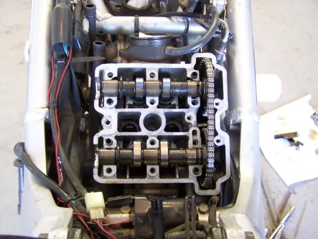

Well it was a few.. thousand.. miles late, but I got around to it.
Ive done hundreds of them in school before but first one on my own personal ride.
Those cam chain tensioners where a *****, so i opted to not remove them entirely and just work around it.
Pretty fun and super easy overall..
This is I, Torquein the cam caps down.
Even got the old man to come get his hands dirty
My way around the tensioners..

Its really not that hard at all man. just take your time, keep things organized. Have a telescoping magnet and use it for the removal and installation of shims and buckets, helps take the "dropping a shim down a small hole" picture outta your mind.
856 Posts
I'm trying to work up the bravery to do that already(6000 miles) when you said work around cam chain tensioners, i would have liked to see that. With the caps removed off the top of the cams i guess you can tilt the cams up just enough to get the shims out,even the ones close to the chain,asked and answered,
I dd show one picture of this, the 1/4 socket wrench with the appropriate socket. Fits nicely under the cross member in the frame. I then "secured" it using the handles of a pair of needle nose pliers.

I am thinking I know the answer, but since there is a pro-trainee to ask...
Is there any way to "work around" the CCTs on the 2ndGen SV650? They have the ratcheting tensioner rod and I suspect you have GOT to remove them (which I have done). Still, figured I'd ask, because that rear one is a total chore.
