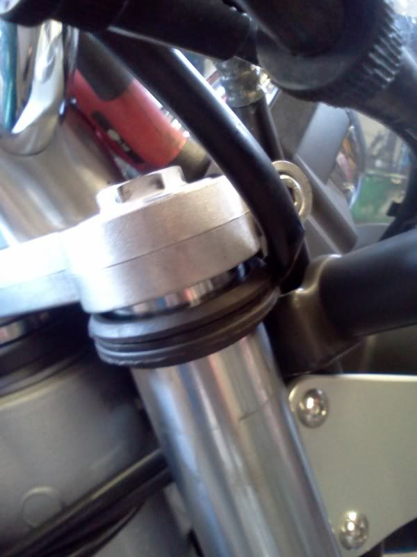

Just changed the fork seals (bike feels great!) and I can't get this rubber ring to sit flush with the triple. Does anyone have suggestions? Or do you can you post a picture of your stock naked triple so I can make sure my forks are placed correctly (at the right height with the triple)

The ring is fine how it is, it's just to hold the headlight bracket in place. I am on my second sv naked, and they both looked similar to that. The manual says to make the top of the fork tubes flush with the top of the triple, and it looks like yours is fine also.
