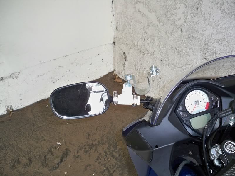

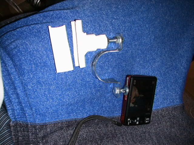

This one is built for the S model and this one is made by JPOnion for the N model Built a camera mount for ~$5 by JPOnion His idea made me do the same but in a different way.

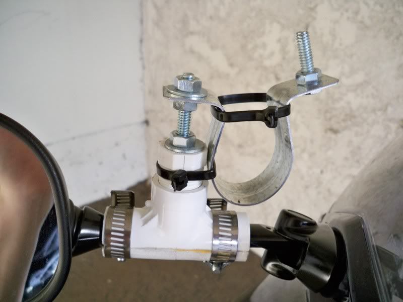

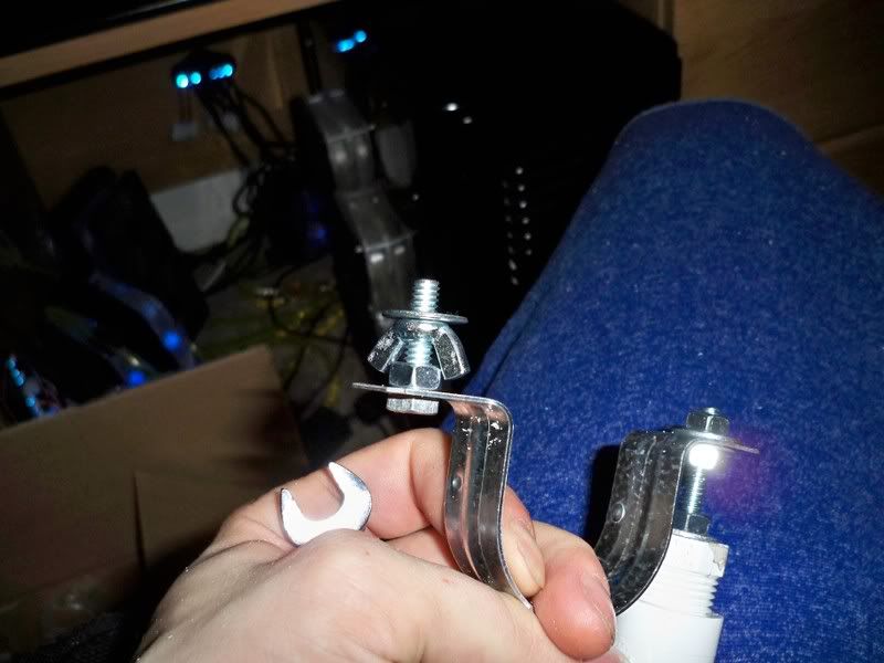

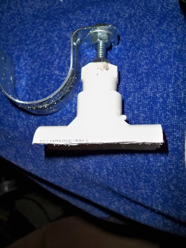

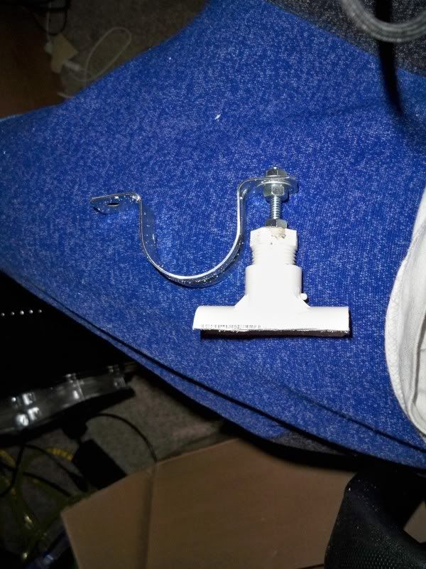

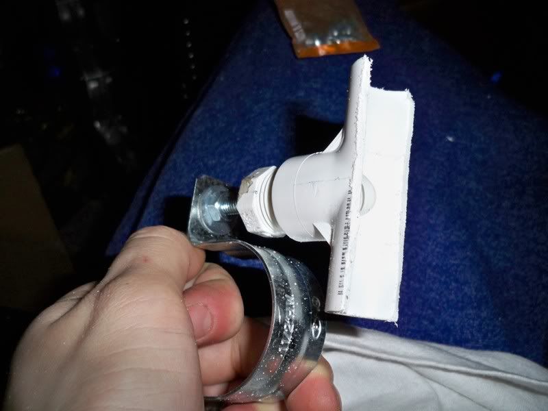

1/4 size bolts, nuts, wing nut and washer, I brought my camera just to find the right bolts as some are fine threaded and won't work I think I used the hew bolts not sure though and then get the 1 - 1/2 two hole strap found in the electric aisle.

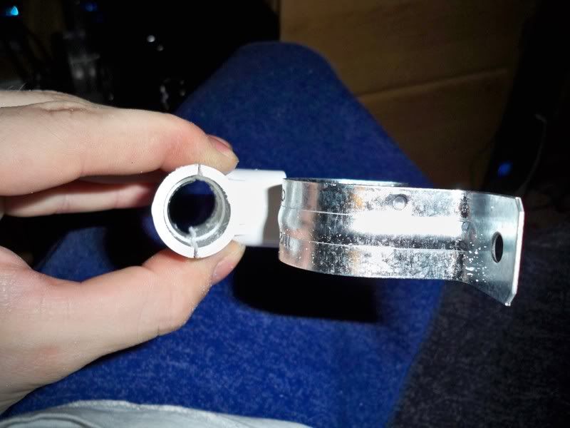

Don't remember the size of the T pvc pipe but I know it just fits over my finger.

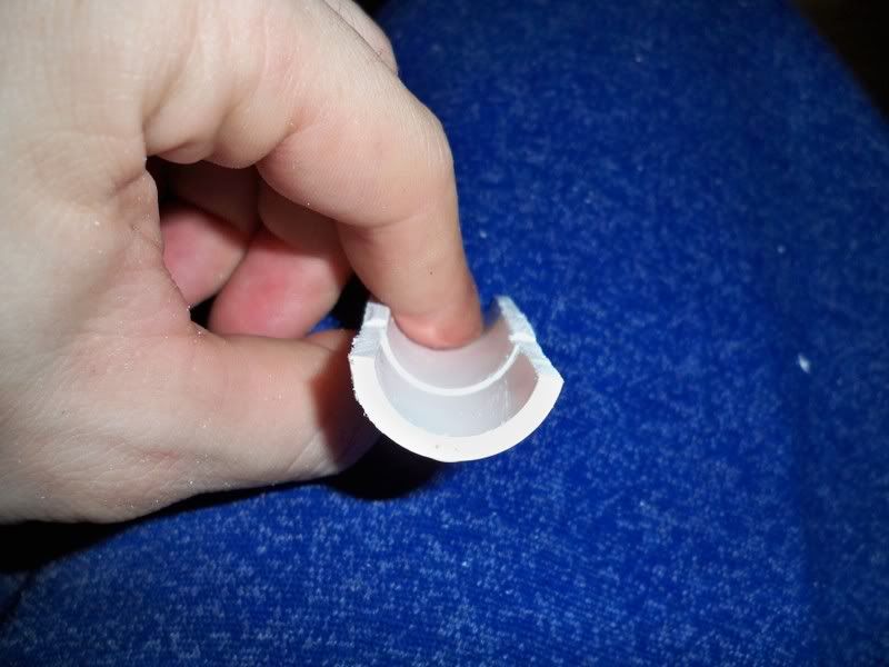

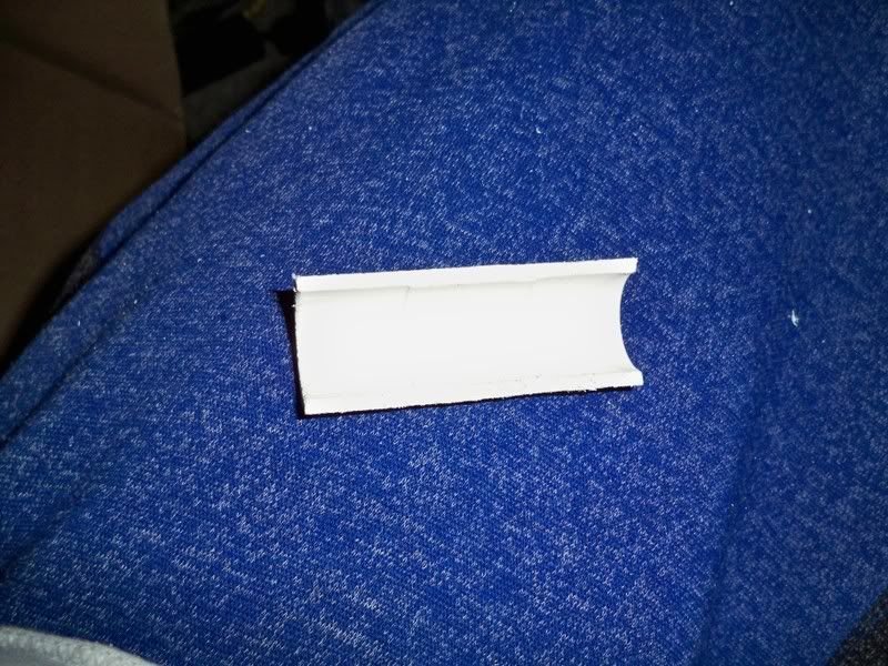

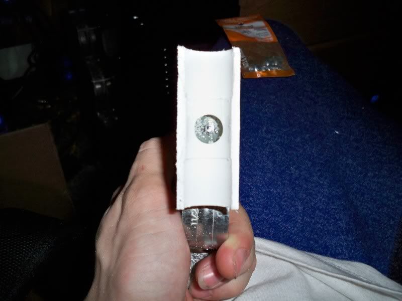

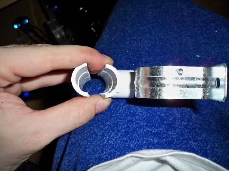

Drill a hole in the cap part of the pvc pipe and cut the T part in half shown in the pictures.

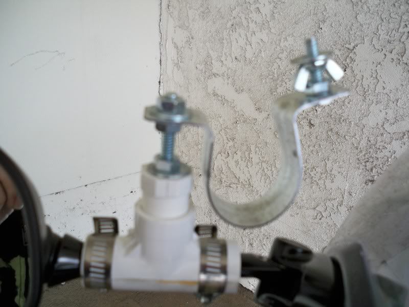

Also used a sponge to put in between the pvc pipe and the mirror bar as the pvc is to bigger by a little bit, between both parts of the pvc pipe your about to clamp on the bike, sorry but I also don't remember the size of the hose clamps forgot to take pictures but they are the only thing I got from autozone everything else is from home depot.
^^^ The wing nut ensures the camera can't move once riding.
^^^ The first video was only the top right zip tie and it was shaking like hell but added the other when I got back home, haven't tested it but it seems alot better doesn't move like it did before.
