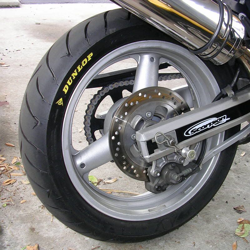

See look how nice is looks on the rear end of the SV!!
Trailer queen it seems. :p
The tire was only 2 weeks old with less then 300 miles on it. I was still scubbing in the sides trying to get all the nipples off. :)
My Roadsmarts didnt come with pretty yellow lettering like yours...
