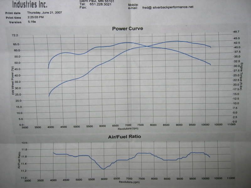

I got my bike dynoed today - first words out of techs mouth - "I've never seen a stock bike run so badly" :BangHead:
Seems like it's running way too rich.
SV650S4K, all stock with 1K snorkel, ~25K miles.
We tried running without the snorkel, without air filter, still way too rich.
And top HP is kinda sucky for a second gen. His recommendation is to get a power commander and remap.
Any suggestions? Why would a stock bike run this way?
Might explain why I can't wheelie :bs:

I wouldn't be so sure something is wrong with your bike, I think there is something wrong with the dyno graph. The horsepower and torque curves should cross at 5252 rpms. Since they aren’t crossing until about 7750 rpm, something isn’t right. I’d go back and ask the dyno operator why.
