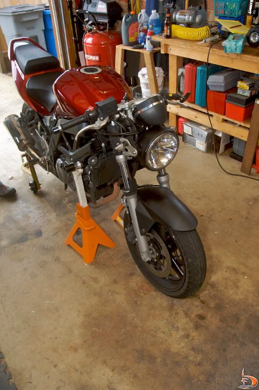

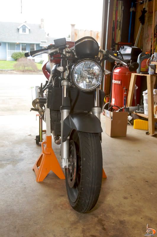

Starting point

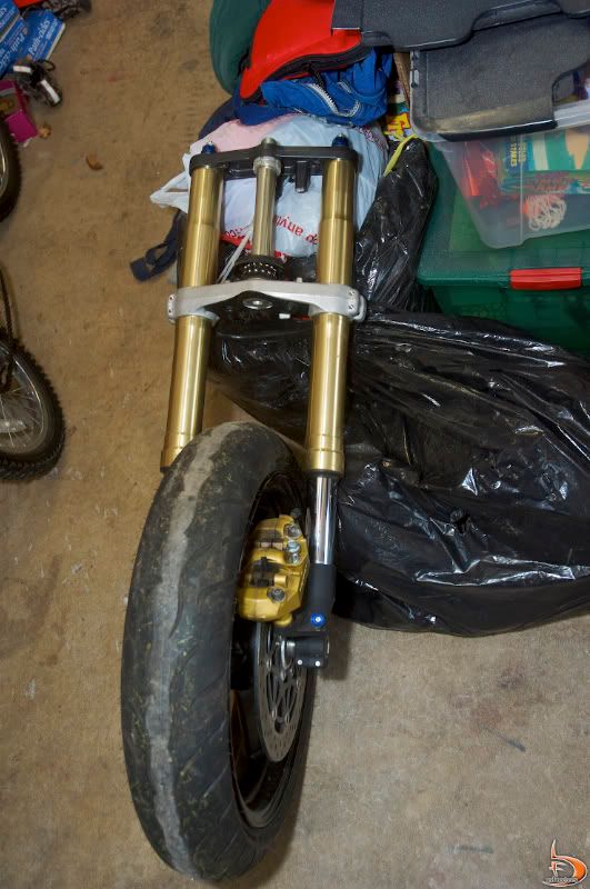

The replacement forks. :smokin:

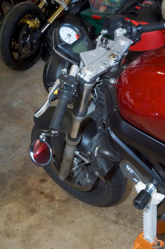

removing the top clamp, head light, gauge cluster, controls, etc.
Hopper (Ryan) and Josh started working on the new front end. It needed to be pulled apart, checked and have new fluid put in.
Vince and I got the front end apart and off.
NOTE: remember this bracket, we'll use it later.
Josh is reusing the controls, put on the new clip ons.
