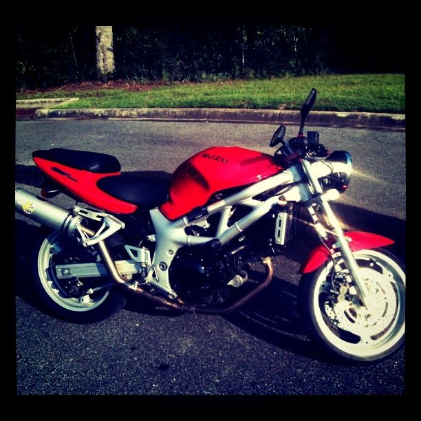

But here goes my second fighter build, and I chose the Suzuki SV650 for it's curvy tube frame and rock solid twin.
So far I've just chopped the rear fender off and remounted the plate and signals, installed Motosliders, and fixed a buggy coil. When I got the bike, the rear cylinder was not warming up very fast at all. Soldered in the connections to the coil and repaired some wire. I still feel like there is a lingering wire issue SOMEWHERE, I just know it. Huge mirrors are getting tossed, but sticking around until I figure out what I'm going to do with the bars. It has the Suburban Machinery bars, which are really nice, but I want a little higher grip and upright riding position.

So anyways, got the basics done to get her one the road, took a short ride today, and I'm really happy with some low end grunt and the Leo Vince sounds mean enough to scare the kids. Me likey.

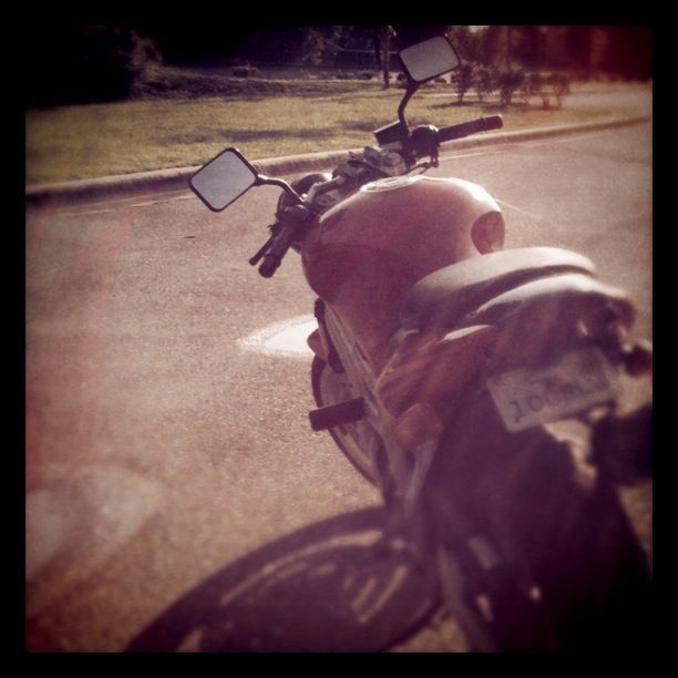

Installed the bar end mirror from my buddy Jared from Custom Fighters, and deleted the stockers. Looks MUCH better. The view of the rear is pretty good, maybe even better than stock. I had to stick my elbow out to see anything with the stockers, now I can see pretty clearly behind me. Took a bit of pigging out other mirror parts and switching hardware to make the mirror work. Had to use a rubber expander and cover it in just the right amount of electrical tape to squeeze it in there and get the rubber to expand inside the bar. It's a little vibe-y while at speed, though. I probably need to go to the hardware store and get a longer screw to fit to another rubber expander in there. Maybe some BB's in the bars. Need to test some more.
