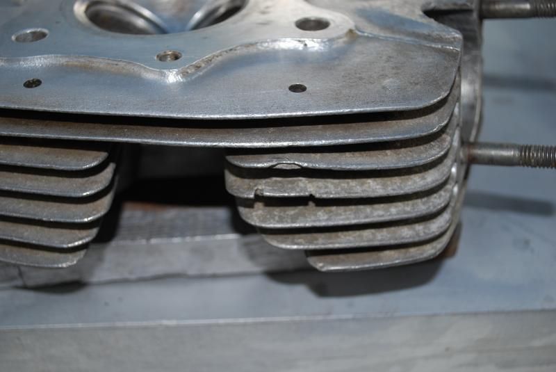

The replacement head arrived today. I spent some time scrubbing it down to get rid of most of the grit and grime. A few of the fins are damaged, two of which have cuts in them like some one took a dremel with a cut off wheel to it. They aren't very deep, but deep enough that they would definitely show after I sand and polish the fins. I will probably fill the cuts with some high temp JB Weld. After it cures I will be able to sand and polish it hopefully to a point to where it isn't noticeable.
