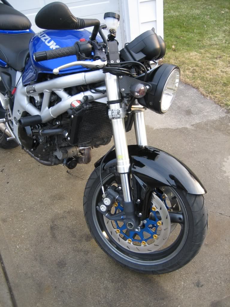

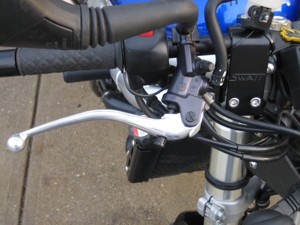

First up, I had the master work his magic on my forks again ('02 GSXR 750 legs in SRAD triples), but this time he did something special: he installed '04-05 GSXR 600/750 knuckles so I could run the R6 radial brakes. ;D Now, my brakes consist of an R6 master cylinder, galfer lines, R6 calipers, and freakin super-duper awesome Alth rotors. Wasn't really a fan of the blue baskets on the rotors, but it has grown on me. I need to order a black pazzo lever to match my clutch side now, but the stocker works just fine for now.
I still need to figure out a good mount for the reservoir, but for now it's zip-tied - lol. You can also see my new Swatt 2.5" rise clip-ons in this pic:

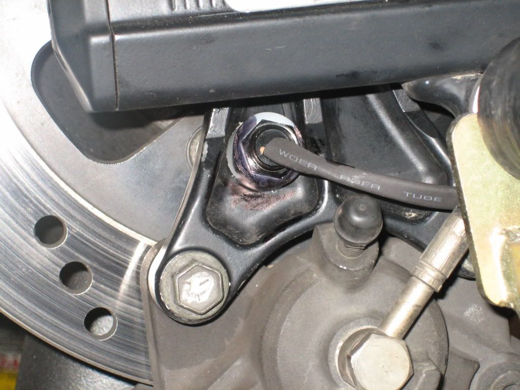

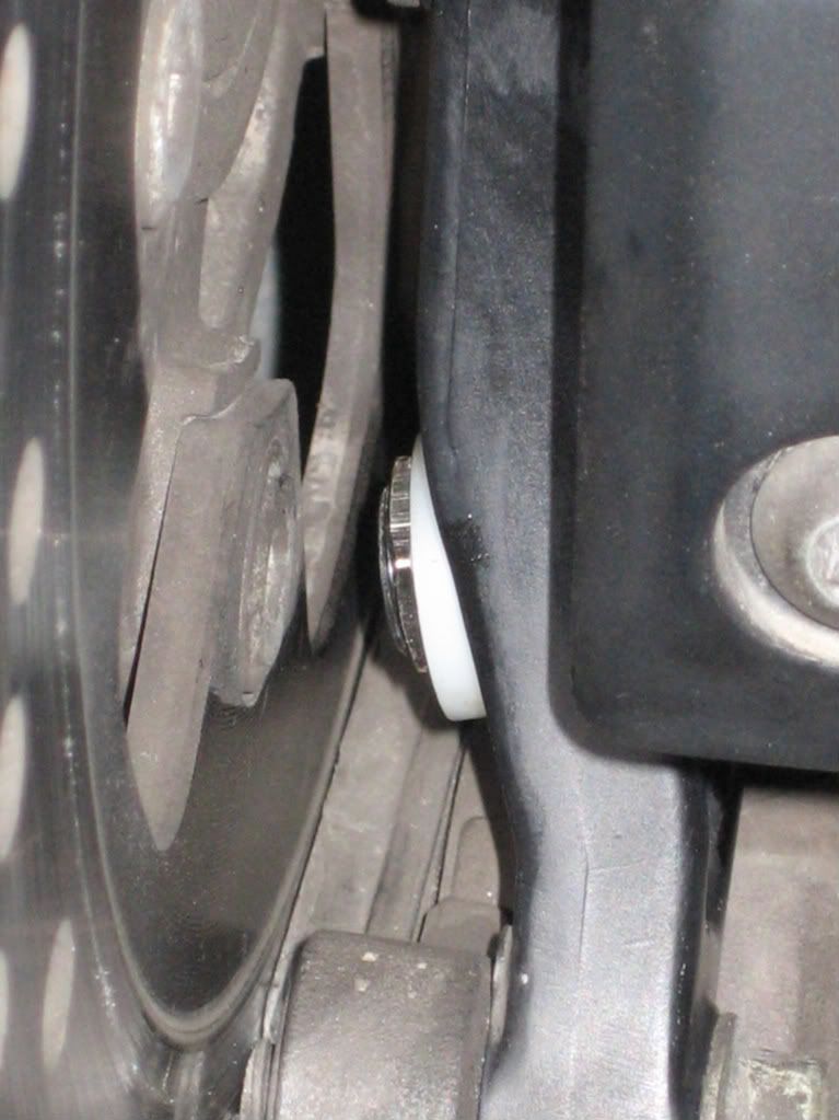

Hall Effect Sensor mounted to the rear brake caliper bracket (the spacers are white nylon, so I took a sharpie to it....poorly. I'll probably replace with aluminum spacers at some point, but they'll probably need to be custom made by someone):

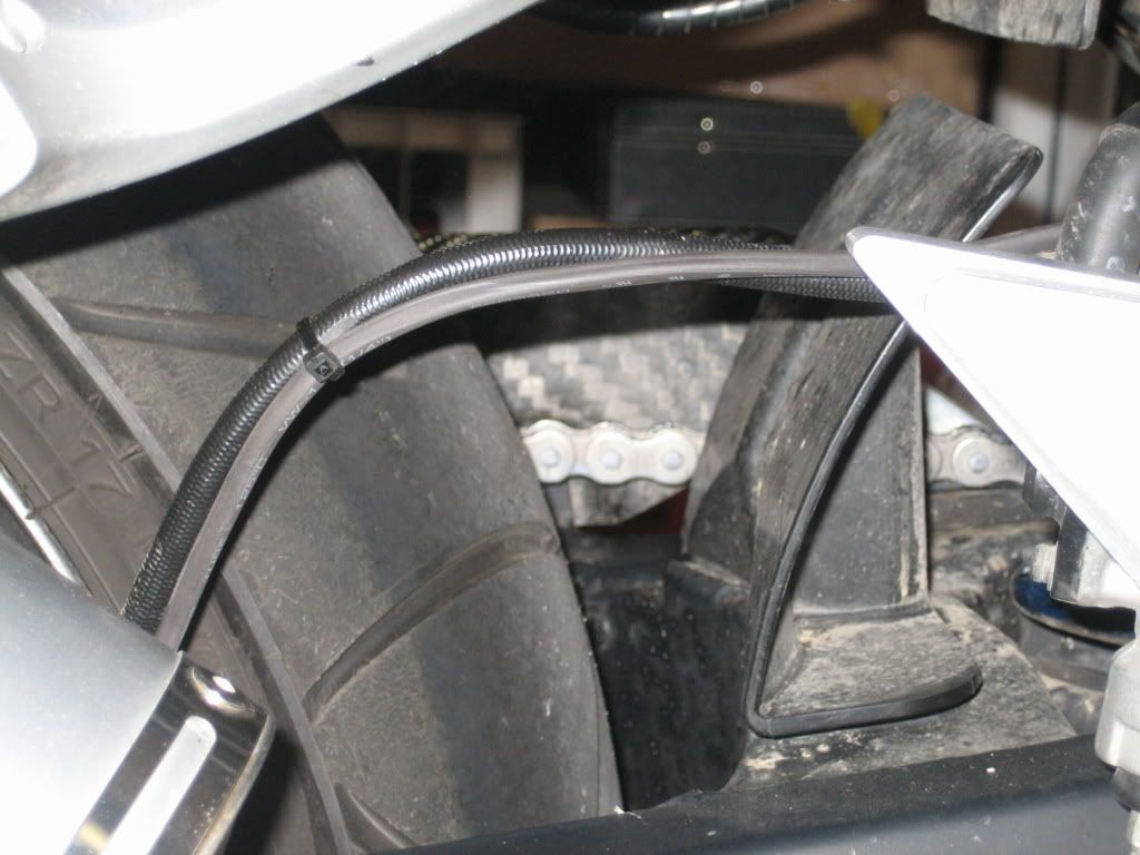

Ran the sensor wires with the brake line:

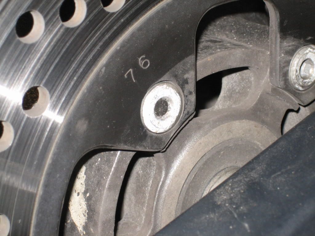

Proximity to the rotor bolts (where I have one magnet mounted)
Found some 6mm OD x 3mm tall neodymium magnets on ebay from the UK. The bolts are steel, so the magnet sticks right in the hole and stays there until I pull it out with another neodymium magnet...no glue, epoxy, or anything:
