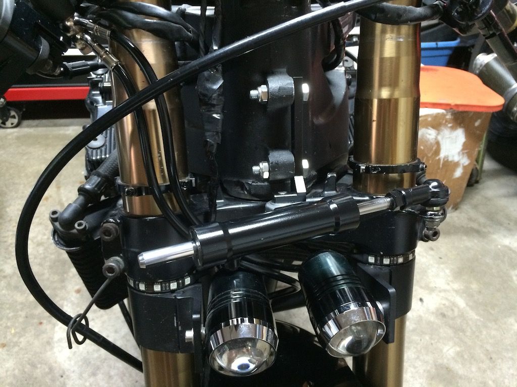

I picked up a GSXR steering damper a couple months ago and finally got around to putting it on. The cool part is that the bracket that the fellow SVRider guy sells on SVStuff.com to fit steering dampers on SV's with GSXR front ends, also fit's on the 1989 GSXR frame! Who'd have thought that Suzuki would keep the same spacing on those mounting points on the neck of the frame for that long. After I bought that bracket off of SVStuff.com, mounting it was easy.
A couple days after mounting the damper, I took the Boiler for it's first real shake down run a couple weekends ago. Went with 4 other SVRiders and logged right around 250 miles total, maybe a bit more. I guess that's the downside of not having an odometer. Anyway, the engine ran great all day and the front brakes never lost their feel, so those were 2 big wins. The suspension did pretty well, but I've got some fine tuning to do on the shock because it felt a little "smooshy" in the corners.

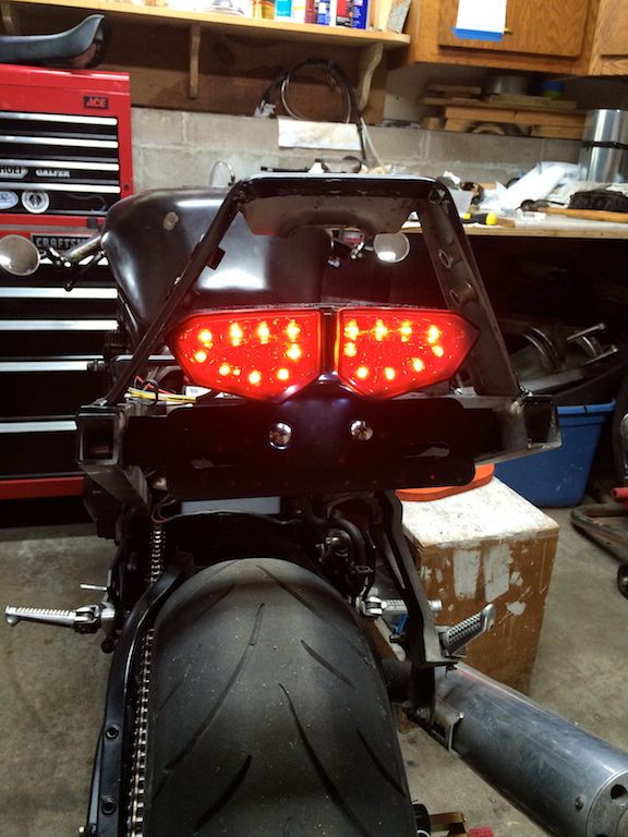

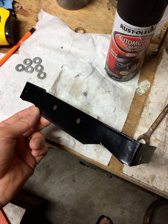

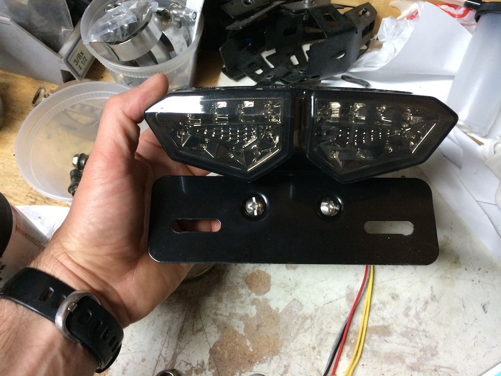

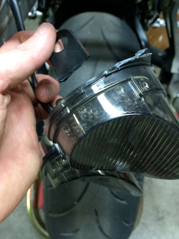

The light has those two bolts to mount it, so I had to make a bracket to hang it from. Without putting to much work into it due to my plans to change the subframe, I just used some sheet metal I had, folded it over for some stability, drilled some holes for mounting it and the light, painted it black and called it good.
And here it is mounted. It's another integrated brake and signal light, so it operates just like my old tail light, and was a cinch to wire up since I already figured the wiring out for the last light. For $22 shipped, not too bad. Hopefully this one doesn't shake apart.
