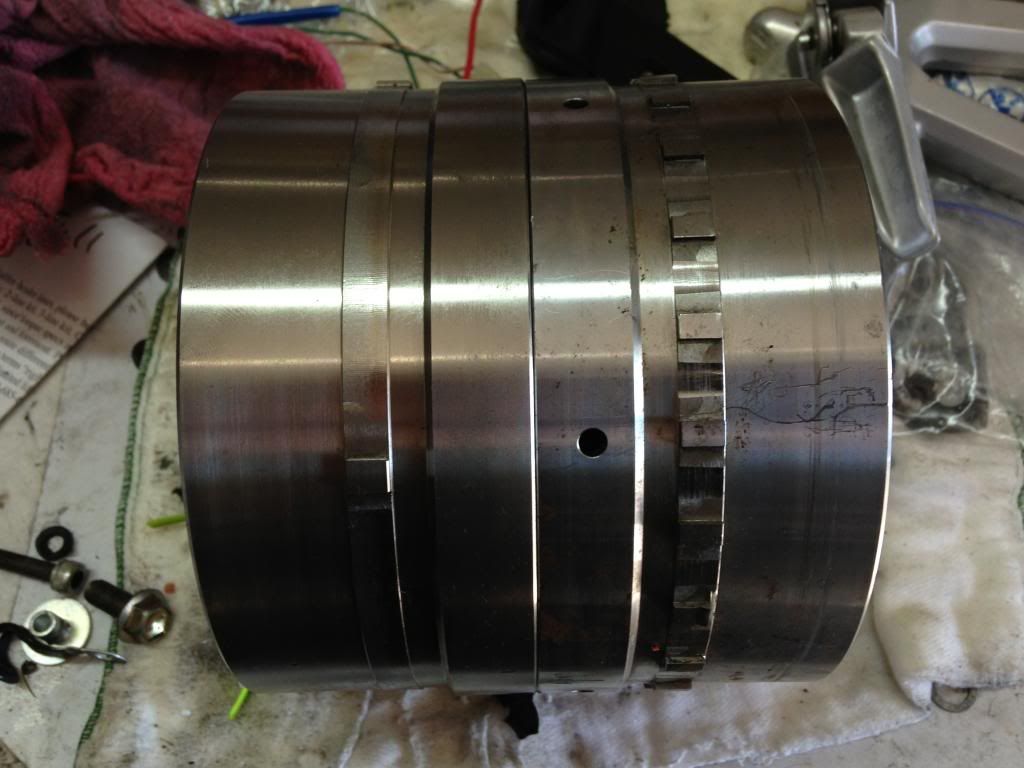

I've been very fortunate, while doing a valve check I couldn't get the generator plug cover off(stripped it actually). So I improvised, removed the entire Magneto cover and saw just one magnet had slightly moved forward a bit. I initially thought to myself, "Hey not bad! Just one moved a little." Nope, I was able to remove three of the six by hand. The other three were still extremely firm on the flywheel and wouldn't budge when I pried at them. I got some sand paper and cleaned it up a good bit. Got some fancy Epoxy by the name of JB Weld, and so far have two of the three buggers re-installed. I am considering this a temporary fix until I get a nice K5 flywheel. I have heard this can happen with K5's as well and a very good contact of mine has informed me to use the Epoxy to make barriers between the magnets. I am going to definitely shoot for this with my current Magneto to provide some additional peace of mind.
I just wanted to share that I, like a lot of others lately, am also plagued with the symptom. I wish we could determine the root cause of this problem. I have no doubt in my mind my bike was ragged on by her previous owner. She's probably very happy to be in my hands getting the attention she deserves.
I put a pic of my current progress, I'll try to update with more as I go along on my band aid solution. Yes, I do realize there is still oEM epoxy on the flywheel. I ran out of sand paper last night and wanted to be proactive so I mounted two of the three magnets and am sanding down the rest of the flywheel surface tonight before installing the third magnet :icon_biggrin:
Magnets when first removed, notice I was extremely lucky and epoxy is still stuck to them and not rummaging loose in my motor oil :)
Two of the three magnets with factory epoxy removed/cleaned up
Magneto with the three removed, prior to cleaning
Magneto with two magnets reinstalled as of this morning.
Again, this is my temporary fix until I get a K5 Magneto. Just wanted to share with all of you.

Honestly I never felt any warnings of this coming on, I'll report back if I notice any changes once I have her reassembled and running again. I could have bought the bike with them already loose(really wish I would have checked sooner). In the past, I have read up about people who don't address this and the magnets collide into each other and shatter or hit the Stator and damage it.
It's really simple to check this, I definitely encourage anyone with a K3(or even newer) to check. It's especially easy with a swingarm or spool stand as this will balance the oil better and you will only have a few small drops come out when you pull the cover off.

I did clean up and install my 3rd and last magnet last night. I did not get time to add a pic, it was a very busy evening and I had to prioritize my time wisely. I will put one up tonight before checking all 3 again and reassembly.

Just wanted to update everyone. I have had my bike buttoned up for a few days now. Took it easy around the back roads of my neighborhood and all felt good. I took her on the highway this morning and have to say that there is a noticeable difference across the RPM range. It's not a completely different bike, however, it is noticeably smoother in the rev's. I really wish I had taken the time to open my bike up last year when I bought her and addressed some of the issues I was reading about. Especially since my bike was plagued with a few of them(Green connector, Magneto, crappy intake mods from PO, chain and sprockets, tune up, lack of pair delete on 2-1 exhaust, etc, etc). None the less, my bike feels...much better. I am definitely going to order the K5 Magneto first chance I get and take it easy on the current one. I know I have some clutch vibration but truth be told, after riding in to work this morning I didn't even notice the clutch basket vibration. Upon my next oil change I plan to open the clutch cover up for a visual inspection. I was hoping to put off any clutch repairs just a little longer, but we'll see what happens next. Ideally I would love to have addressed major issues like this with a motor rebuild. I'm not ready for it yet, so I'll be fixing all the little things I can along the way.
Too all SV1000 owners, I strongly recommend opening the generator cover and just inspecting your magnets. After going to the portal per Mr. Schmidts recommendation, I was pretty amazed how many people have this problem. It's worth opening the generator cover just to have peace of mind for your 1000.
Good luck everyone! Hope you don't have loose or destroyed magnets. If you do, just know there is hope still.
