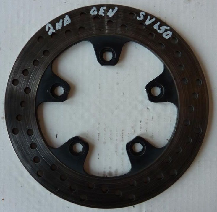

Stock 2md generation rear brake rotor

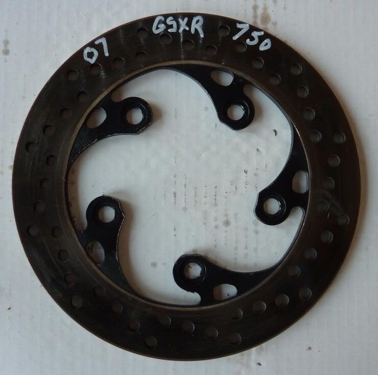

Stock GSXR rotor. Even though the part number is different and mounting tabs are configured differently it will fit on a 2nd generation SV650

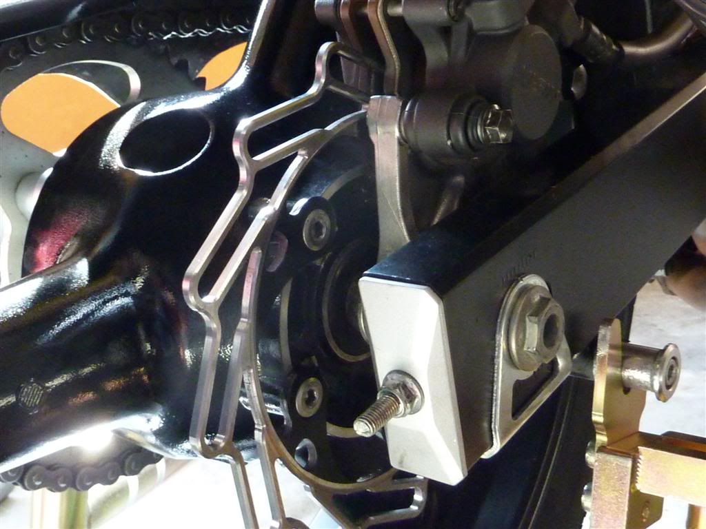

Lightened rear brake rotor.
Lightened rotor on SV650 rear wheel

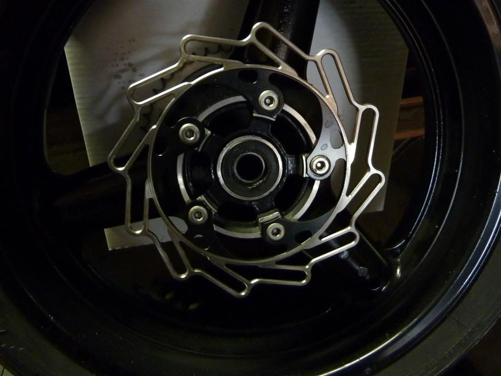

Lightened rear brake rotor installed on SV650
