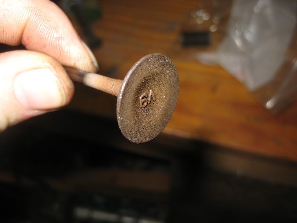

But first, i do have a question. I know people buy shim kits, nothing in the Haynes manual says anything about fitting, replacing or measuring the shims... what am i missing? i am going to re-lap the valves, so i would assume it is necessary.
Okay to jump right in.
here is the head with the valves in (i took two out before realizing i needed this picture)
Then i rigged up my handy dandy very expensive special tooling
the clamp has a round piece of soft metal on the bottom to contact the face of the valve, and then uses the piece of pipe to compress the spring retainer but not the followers so i can use a pair of tweezers and get them out, freeing the valve.
As you remove the valves, make sure you keep them not only separate but labeled so that you can put them back in the correct spot. I used bags. it also allowed me to record the valves stem diameter as well as the inner and outer spring free length to see if they were in tolerance.
Then i cleaned up the valves (making sure to keep them in separate)
